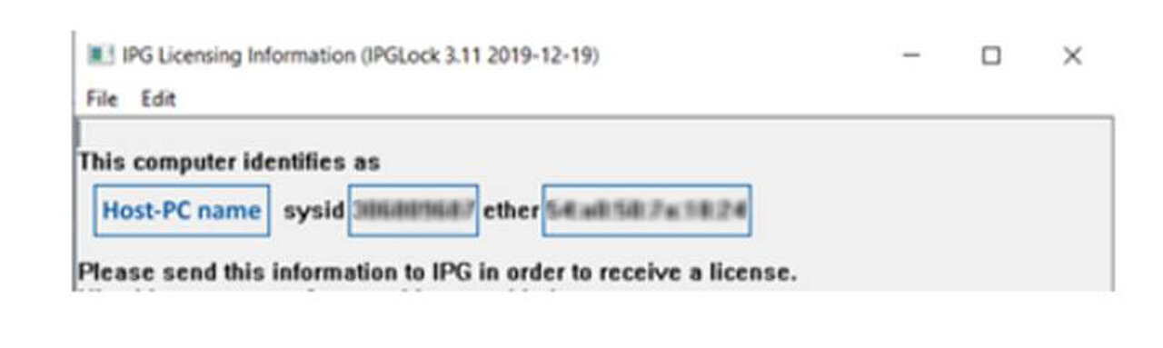

Instructions for Windows users
  • Download the file wlicinfo.exe here
  • Please disconnect dockingstations and other hardware
  • Double-click the file to execute it on your PC
  • A window opens displaying your Host PC name, Windows specific SysID and MAC address
  • Please enter the displayed information into the corresponding fields in the test license request form

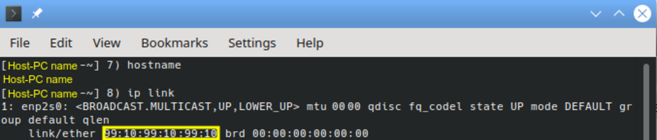

Instructions for Linux users
  • Enter the command "hostname" in a command window and hit “Enter” to display the Host PC name
  • Enter the command "ip link" in the same command window and hit “Enter” to display the available MAC addresses
  • In case more than one MAC address is listed, the address displayed next to "eth0" should preferably be used for the test license request
