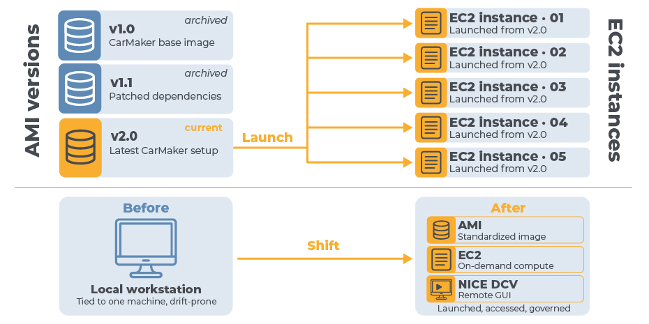

  2. AMI pipeline: This pipeline produces the standardized environments. Using EC2 Image Builder, it starts from a base Amazon Linux image, installs CarMaker together with the required project files and license configuration pulled from S3, and captures the result as a reusable Amazon Machine Image (AMI). Environments therefore become versioned artifacts rather than hand-built snowflake machines: one image can be launched many times, identically, on demand.
  3. EC2 GUI pipeline: This pipeline gives engineers an interactive CarMaker desktop in the cloud and decouples CarMaker from any single physical workstation: the same standardized session can be started, used and shut down whenever needed, replacing a fixed local install with a consistent, on-demand remote one.

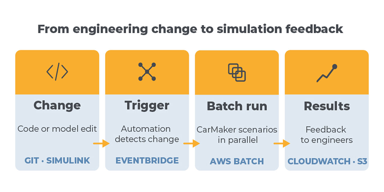

Two further ideas make the workbench a genuine engineering platform rather than a remote runner. The first is change-driven regression. Because the whole system is defined in code and orchestrated by pipelines, a change to a feature, model or scenario can automatically trigger the relevant simulations. Validation then behaves like a continuous-integration process – an integral, automated part of development – instead of a manual step performed on the side. Engineers gain fast, consistent feedback whenever something changes.
The second idea is observability. The principle is simple: what cannot be measured cannot be scaled. The front end integrates a native Amazon CloudWatch dashboard, organized into KPI sections for all simulations, braking, rollover, as well as handling and stability. For richer analysis it can export KPI datasets to Amazon QuickSight, scanning the results in S3, publishing run-level and summary CSV datasets and setting up the supporting Glue and Athena tables automatically. Metrics such as runs per week sit behind the simulation workflow, so teams can see throughput, spot bottlenecks and make informed decisions about where to scale.
