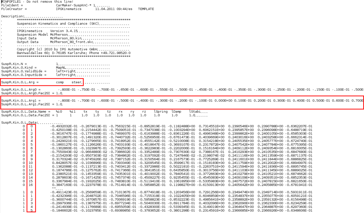

From CarMaker version 5.1.1 onward, it is possible to use a rear steering degree of freedom (DOF). Similar to the front axle you can provide the wheel position in dependence of the steering rack by the corresponding entries in the skc file.
If the steering rack movement of the front axle is not supposed to be transferred one-by-one to the rear axle steering movement, it is also possible to define a FACTOR (".Fac2SI") or OFFSET(".Offset") which is applied to the steering rack DOF in the skc file.
Please find below an example how a skc file for a steered rear axle could look like:

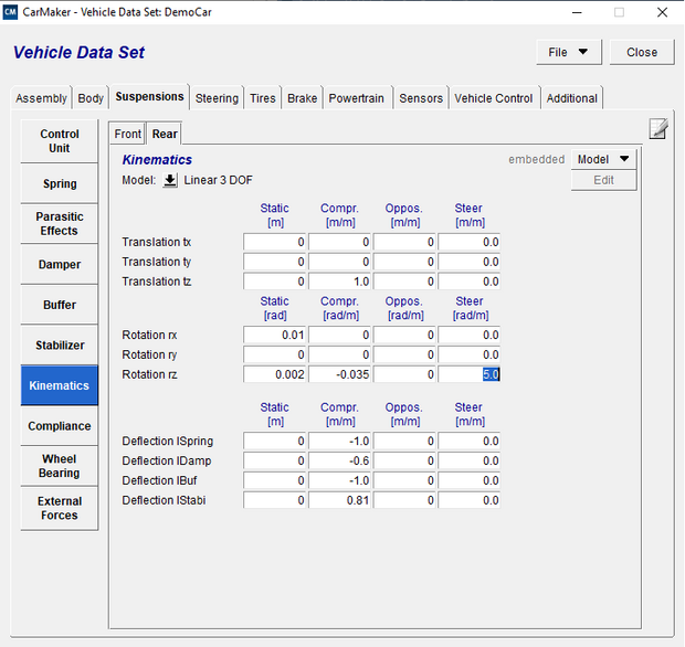

  8. Open Vehicle Data Set
    “Examples/ExtraModels/DemoCar_MySteering”
  9. Select in Vehicle Data Set > Suspension > Kinematics > Rear to “Model Linear 3 DOF” and set “Rotation rz” to 5 [rad/m]
  10. Start simulation
