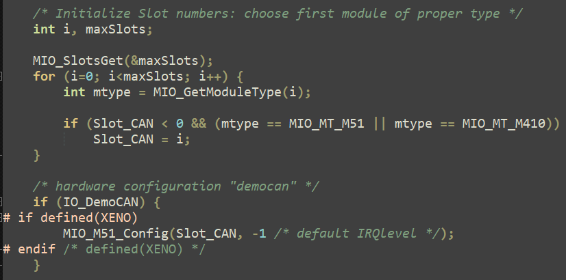

The following sections for identifying the last slot with a CAN module and the initializing such a module on this slot must be removed:

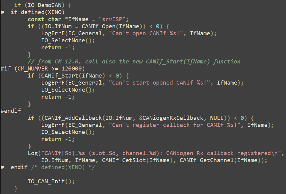

The following section, which is also used to initialize the CANiogen module, can be used to open a CAN interface by simply specifying its name and adding a function to be called when this CAN interface will receive data:
Depending on the used CM version it is necessary to include the header can_interface.h from IO.c to avoid some warnings during compilation.

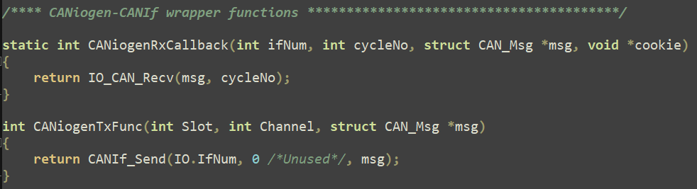

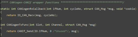

The passed callback still must be implemented. It consists of a function that wraps the relevant CANiogen function:

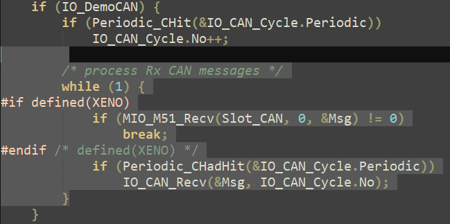

Since the received CAN messages are now processed by the callback function, the while loop and its entire content can be removed from the IO_In function.

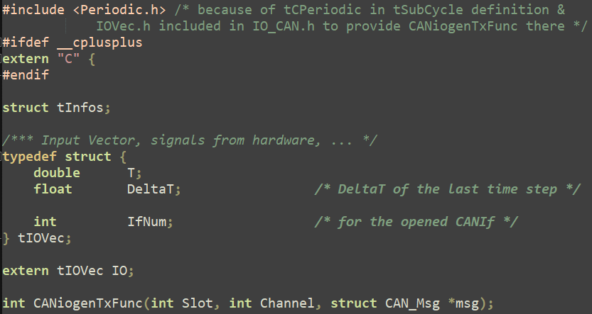

In addition, the header IOVec.h must be edited
  • to extend its structure to another member, which is used to identify the opened CAN interface
  • and to let know that the wrapper send function is available:
Please also note the inclusion of the header Periodic.h in order to avoid an error related to tCPeriodic while compiling IO_CAN.c in the next step.

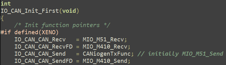

Once done, edit the IO_CAN.c file
  • in order to include IOVec.h
  • and to set the corresponding function pointer on the wrapper send function:
