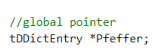

1. The first step is to create a Data Dictionary variable which is named Pfeffer in this case.

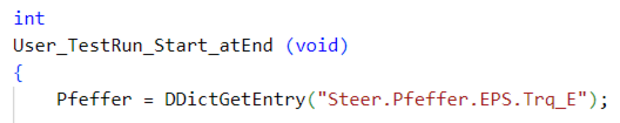

2. After declaring the variable, you can read the desired UAQ and pass it to the Pfeffer variable using DDictGetEntry(). This should be done in the initialization function User_TestRun_Start_atEnd.

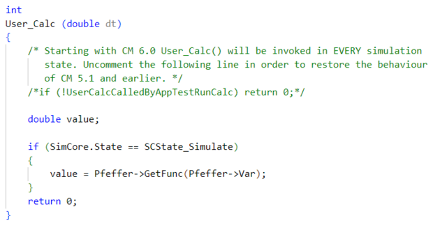

3. In User_Calc, GetFunc() is used to copy the current value of Steer.Pfeffer.EPS.Trq_E to a local variable value.
To write the values, you should use the SetFunc function instead:
